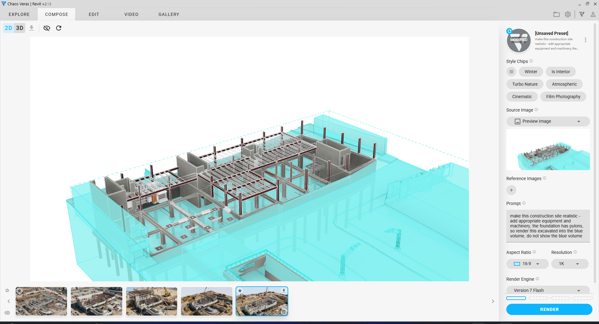

Use a Section Box to start with the lower level—I selected the site so I can have x-ray vision for some of the structural members.
Chaos Veras AI interface in Revit displaying a stylized teal-colored site excavation and massing model.
Then, render a still in Veras.
AI-rendered 3D construction site in Veras featuring realistic excavators, dirt, and structural foundation.
